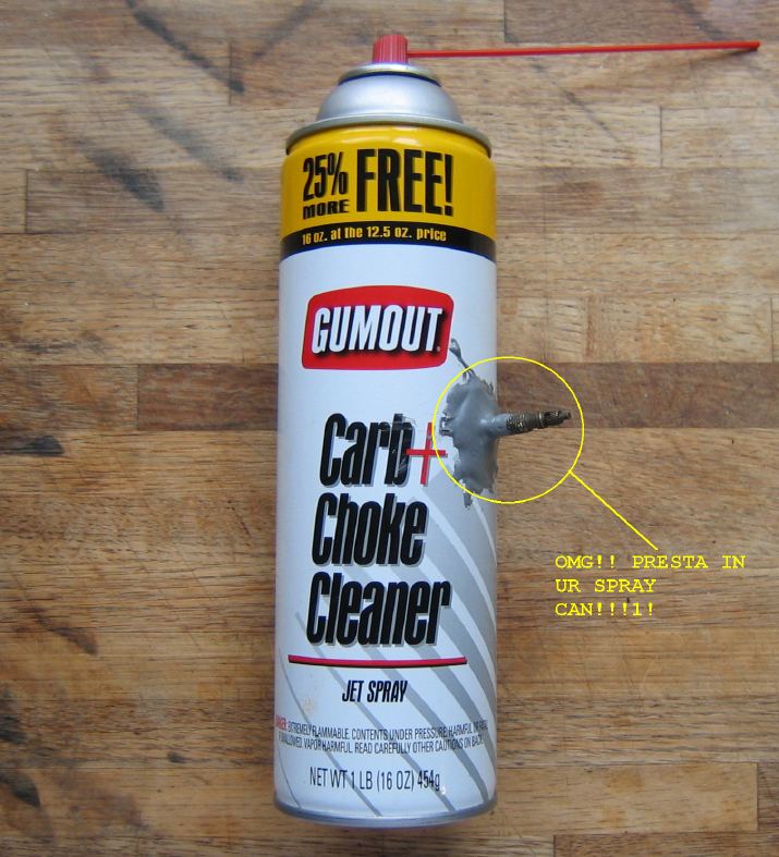

BONUS FOR THOSE STILL PAYING ATTENTION!!!
Here's a cute hack I learned from instructables.com on how to repurpose a used spray can to pump up with air for cleaning parts. When air compressors are not part of your studio apartment's equation:
![aircan.jpg](http://lh5.ggpht.com/_odYlEehadAs/RziBxgbmnfI/AAAAAAAACes/wuc0ZX_ntjE/s800/aircan.jpg)
