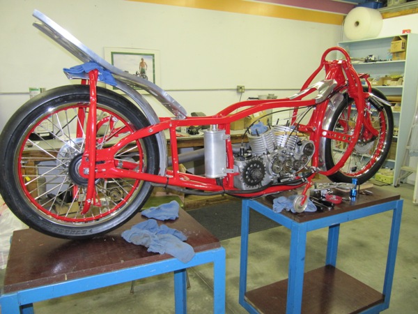

A good idea of how small the bike is. The fairing is about 14 feet long.

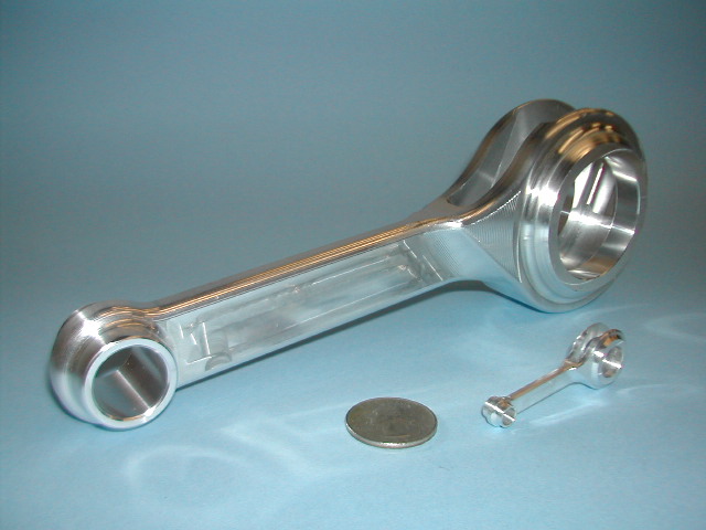

The new rods. I read as much information that I could find about Burt Munro. In one book he mentioned that he wanted to try aluminum rods but never got the chance. So I thought I would grant that wish for him. They are the same weight as the steel ones that I took out. You can imagine how thin they were. He broke lots of them.

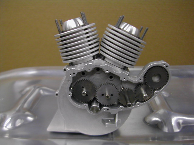

It was a privilege to work on the bike. I am building a quarter scale running model of the bike. So I needed to measure the real bike. I made a deal that I would get it running again if I could measure it. Turns out making a quarter scale running engine that is absolutely to scale of the original is a bit tricky. Here is a shot of the quarter scale engine sitting on the full scale bike.
Quarter scale and full scale rod.
