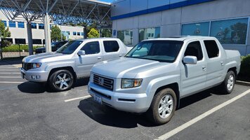

I love those stupid little trucks. The first gen ones.
Yep. Drove my first one for 20 years/220k miles. Planned on buying another new one, but found out the 2nd gen's are too small for me in every way.
I found a super clean 2014 (last year of gen 1) w/ 60k. I bought it from a dealer (which makes me sick :green)... and i probably overpaid by $2-3k... but they gave me $2k for my old one (it was hammered!!)... and it was the same color. :laughing
