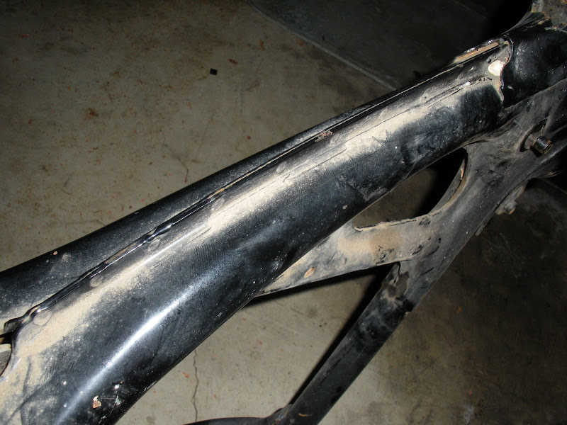

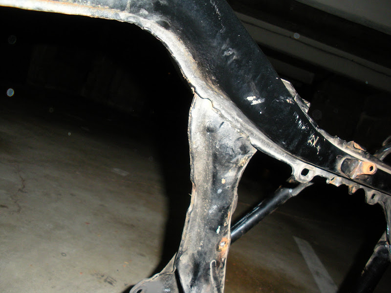

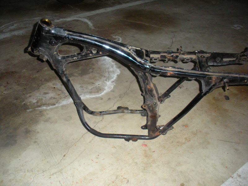

Okay, I bought the frame of a motorcycle today: a '73 CL350. Shouldn't be too different from the CB frame. Charlie picked it as one of his cleaner and straighter frames, even though it looks bent and twisted. Charlie says, no, they're all like that. Crazy way to build shit if you ask me.
So these frames were designed and constructed to be cheap and easy to manufacture, not to produce sweet-handling vintage roadracers. Not by a frigging long shot. I denigrate tube-steel frames when I review a motorcycle: oh, how I long for a tube-steel frame. No, this jus tlooks like tube-steel: the main structural member is actually folded mild steel crimped--yes crimped, like a tin toy--together along the seams. Nice!
It's not even that light: I'd say about 30 pounds or maybe even more.
"Oh, yeah," said Charlie, as I carried the frame out of his parts room, "look out for spiders. Lots of spider in there."

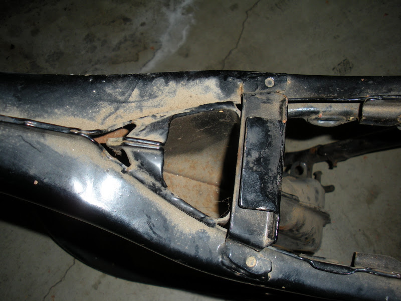

Another detail of the backbone, showing the tab.
So what I need to do is have a welder/fabricator grind down the seams and weld them solid. Then we'll take it back to Charlie, who will match up the seat to mount that and then remove extraneous brackets and other stuff.
