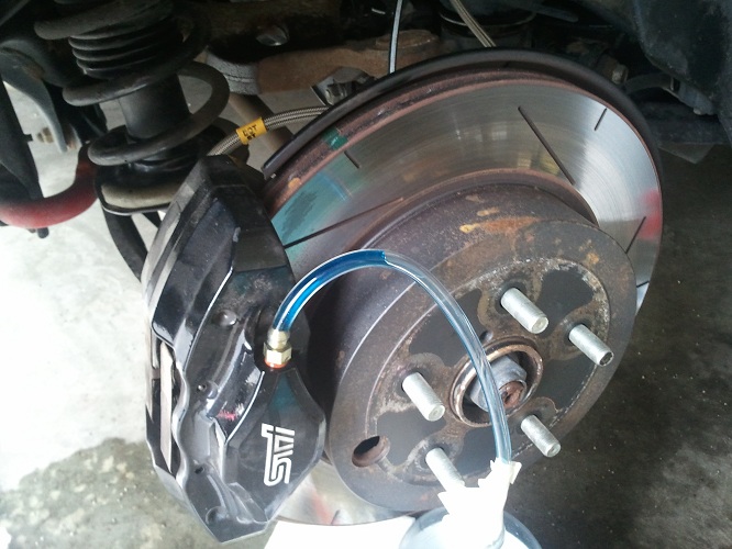

No issues if it looked like this:
Another bleed should take care of most of the residual blueness if it bothers you.
Edit: looks like Hooli beat me to the punch. That's what I get for opening half of the "new posts" page before reading through each one :laughing
