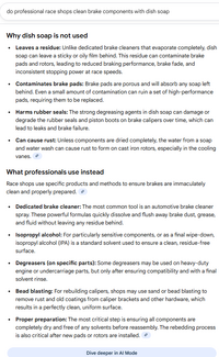

All Professional race shops, you speak for? But they are so fuggin cool because their bikes seem to get serviced like every 10 minutes of use, and everyone is a honed purebred uber, oh, and the fuggin tools, top quality hi pro parts everywhere.
I'm sure every entity in the world experiences the use of regular detergent and scrubbing tools like a brush. And I am sure that many have noticed that regular detergent and an inert scrubbing device ain't going to clean everyday highway grime, tar, oils, grease, bug shit, and deer jizm off.
I want to read this statement posted from a real race shop, on their company letterhead, attesting to this claim, that they use dish soap and a brush, and nothing else, to clean brake components, as has been represented here by @jbawden and @Enchanter.
I wasn't able to find any letterhead tonight. Hopefully these links are okay.
Random dude uses 'soap'.
This backwoods place calls for Simple Green. In my experience cleaning water fowl, Dawn isn't as harsh as Simple Green.
This po-dunk organization calls for soap too.
Then there's this place:
