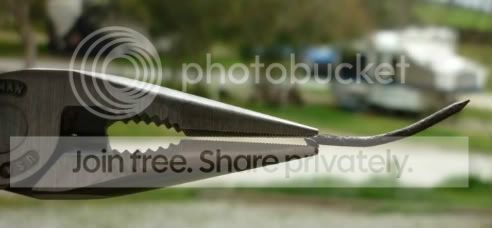

Another time I was in Arnold with a group of friends when one said, "Oh, look!" and pointed at a nail in my KLR's rear tire. I pulled this out; luckily, it had not pierced the tube, I ran that tire for another several thousand miles:
