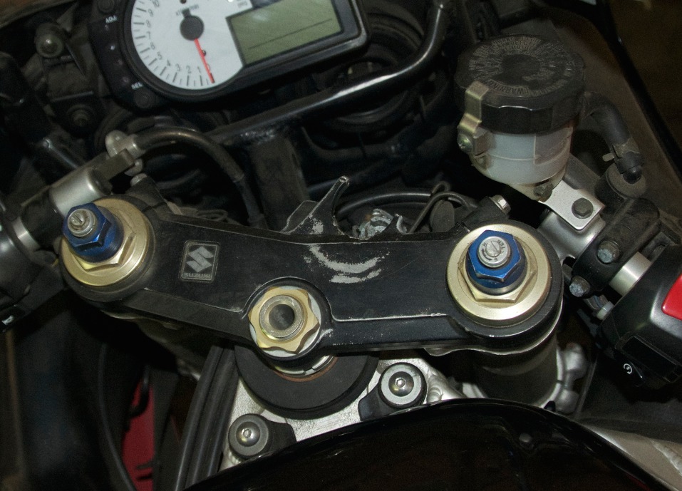

Someone tried to steal my bike awhile back and broke off the ignition. Anyone know how hard this is to fix? (Photo below).
Since I'm in the process of moving I'm trying to figure out if it's worth pushing my bike 1/2 mile to my new house and getting it repaired or just calling someone up to junk/scrap the bike and buy something new now that I have a proper garage to store the bike in.
Bike is a 2001 GSXR 750. Up until the attempted theft it was in good condition but it's been sitting for long enough it probably needs a full overhaul.

Getting new parts and installing them is pretty straight forward. Www.ronayers.com can give you an idea of worst case prices for the parts. Given you don't seem to be in any hurry, I would look for used parts
edit:
lock/key looks to be around ~$133
top triple (head, steering stem in suZuki speak) is ~$225
just for reference
also check yer pm, i might be able to help one way or another

When they took the lock I think they might have also broken/taken the wire for the ignition. I'd have to go take a closer look again to be sure. If that's gone then I assume it's a bigger repair to fix the wiring harness?

The harness for the ignition cylinder is a sub-component. It goes from the cylinder where you put the key in down to a plug (usually under the tank somewhere, so it's not accessible without a tool/time investment which makes it impractical for a thief to try to get to), where it plugs in to the rest of the wiring harness. So you don't need to change the whole harness, just the part that is missing/damaged.
The harness for the ignition cylinder is a sub-component ....
Just to clarify (because I had to read it three times to understand what I think you meant):
It's not a sub-component of the Ignition Key-Switch - the Key-Switch comes complete with the harness that plugs into the Main Harness connector.
(but I think that's what you meant - it kinda reads like the switch and the switch-harness are separate parts)
i.e Buy a key-switch and plug it in.
You should be able to find replacement top-clamp on EBay - either OEM or an after-market replacement.
http://www.ebay.com/itm/SUZUKI-GSXR...Parts_Accessories&hash=item2c8a5b4ca0&vxp=mtr
You will need set of Security Torx bits if fitting OEM screws, or you can just fit regular socket-cap screws to bolt the key-switch to the clamp
Scrap it out for that? That's pretty minor repair.
If it's been parked up for a while, you might need to clean the carbs out.
