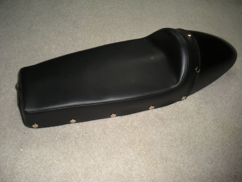

Seat Arrived Today
The tail section arrived from Glass From the Past...well worth the wait. For $200, it's pretty nice. Custom-made for my bike, very professional-looking upholstery (that easily comes off with snaps), strong and stiff, and very light: 2 pounds 10 oz. Well worth the wait.

That is a great looking seat, Gabe. Is the black a primer? Color coat? Did you specify a color?
I think it's just the fiberglass, unpainted. I don't think he does paint. Paint will be phase two in 2011.

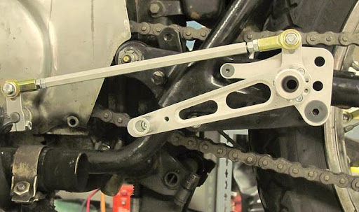

Just when I thought I was SOL finding a supplier for rearsets, I stumble on this:
http://www.motobits.com/vintage.html#CB350

I've got authentic original Dunstall Rearsets on my CL350, but now you've found those lovely pegs, I'm considering chucking them in the bin and ordering those!
My Dunstalls don't work with the kickstarted, and since I've binned my electric start, I think I should trade up!
Hey killfile, would you mind posting up a picture of the frame/ rear sets? I am interested to see the difference between the CB/CL350 Twin and the CB350 Four frames....
I've posted this picture before which I don't think will help much. I'll try to take a few more pictures tonight and post them in the morning for you. Unfortunately, we used to have both the 350 Twin and 350-F in our garage, but sold the four a few years back, otherwise I could do a detailed comparison for you!
