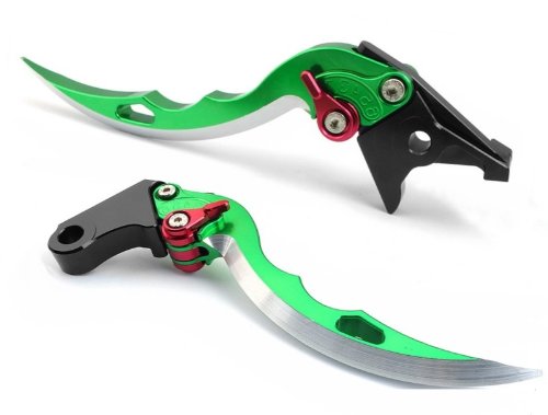

front brake locking up
Do you have aftermarket levers? I've heard of the cheap knockoffs not being machined well enough and putting pressure on the brakes, eventually causing them to lock up. That's usually on the track though...
There's a ton of these reports from street riders.
In fact, all the reports I've read, on ZX-10R.net, are street.
And..The Ebay Chinese knock offs.
On DRZ's you can adjust the little pivot thing that pushes the piston on the master cylinder. I adjusted it too close once and had the brakes slowly
lock onto the front rotor. Luckily I was close to home and just loosened the adjuster and let it cool down. Put a new set of pads on and I was good to go.
It happened slowly though, so it felt like the engine was losing power and I just pulled off to the side of the road with the bike not wanting to move.
Anyway get a set of stock levers, they aren't even that much at the dealer or online.

Looking at the picture, you're lucky you didn't lose fingers when you crashed.
Oh my gawd! Only an i%*¥€£ would put those on their bike.
I think they might add to the aerodynamics of the bike..... I kid, those are the trashiest looking pieces of kit I've ever seen. :barf
And the person who put them on needs meds. Or stop taking illegal meds, one of the two.
I think those levers are actually pretty cool for a show bike. But I would never ride with them.
Those levers are so Florida. I could see them on a Busa with a 5 foot stretched swing arm.

Brembo isn't going to leave a fondue fork hanging out in the breeze.
If the point was to have a breakaway tip, they would cast in a simple slot halfway on the backside of the lever that acts as a fracture point.
Since I brake and clutch with my middle fingers, I don't think I would be riding very long with these. The only two things that I can think were as crazy was a OCC bike with the sissy bar spikes facing the rider/pillion and another with an axe blade for a triple facing the rider.
These are really masochistic weirdness. Who would even think of such a thing, let alone use them? Sorry o.p., but jeezbus. :wow

I was one of many who had problems with aftermarket levers.
I bought a set of CRG knock-offs from Cyclegear. I pulled a very scary stoppy 1/4 from my house on a test ride - and pushed the bike back home after waiting 30 min for the pressure to bleed down.
The problem is insufficient clearance between the lever and the end of the rod that actuates the piston in the MC. It stops piston from completely returning when you get off the brakes.
Each application of the front brake pumps up the brakes a little bit more, so they lock up sooner or later.
I fixed it by drilling the recess in the lever 2mm deeper. Its been fine for >1000 miles.
