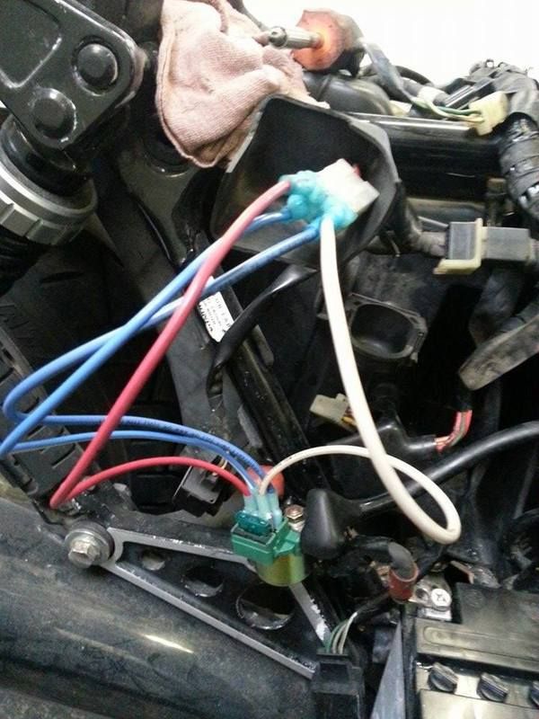

I finally got a couple hours to work on the Nighthawk! :ride
Battery holds a charge, installed it with the correct polarity, held the the starter button down, and bypassed the solenoid with a screwdriver.
IT STARTS! :teeth
The clutch wire (green & green/red) insulation has partially melted off the conductor. I'm going to disassemble and solder on new cables. Or should I just buy a new switch?
While the bike was running, I decided to try out the Green/Red to Green connection. I thought maybe the short was in the switch side. Nope. The fuse blew. Regardless of the ignition position on "OFF" or "ON". but I THINK it's okay when I disconnect the rectifier. Engine starts up with and without the rectifier. So this is getting interesting, right? :wtf
I thought maybe it would be a good time to swap out the old harness. SO I unplugged everything but the rear lights and plugged everything into the new harness. No change in the symptoms.
Did I mention that I have to keep my thumb down on the starter button to keep it running?
Or that the engine starts and stays on regardless of the ignition position?

Glad you're making progress. Electrical is fun, like a puzzle where you have to make your own missing pieces.
Most times, jumping the contacts on a solenoid/starter relay will turn the starter by itself. Shouldn't care whether you're hitting the starter button. The starter button's job is activating the starter relay, which the screwdriver is doing instead. Maybe it does other cool stuff on Nighthawks though, I'm too lazy to look up a wiring diagram.
At a guess, I'd say the whirring noise coming from the case could be your starter continuing to spin, because you're continuing to hold the starter button and the screwdriver. Neither of those things should be needed to keep the bike running, and they're definitely not good for the starter or starter relay. Plus all the current drawn by the starter can do funny things to your bike's electronics.

ChannelCat, you're abundance of straightforwardness and kind words is much appreciated. I got the bike running today. :thumbup
I did research prior to purchasing the bike with my buddy and should have gone with my gut. The generic solenoid has the leads oriented flipped. To test this, I used some conductors with spade connector crimps and the bike started right up. :rofl
It's been really frustrating but I'm glad I've learned a lot from everyone's suggestions and efforts... even my uncle's. :x I now feel much more comfortable with working on the bike and next up with be the oil, spark plugs and carb (most likely in that order). :party
To think I'll need to spend $80 on harnesses and button assy to solve what I could have done with a pin remover. I'm going to rearrange the orientation by removing the conductor leads and place them according the generic solenoid.

Ah, shit. If you'd have taken a picture of the solenoid, I could have told you a lot sooner.
We ran into this years ago on the CX forum when people were buying that solenoid type on e-bay and their bikes suddenly "stopped working."
I have that exact solenoid on my Eurosport.
The Honda connector just gets turned 180 degrees and slides right in if you cut off the locking tabs.
Good job working it out.
Thanks! :teeth
Hahah Yeah I figured that after the fact... but the plug on this particular aftermarket solenoid won't accommodate the connecter backwards, even after I cut the taps off. :thumbdown
But I'll unplug the pins and switch it that way. Just have to make sure that I swap it back if I come by an OEM or sell the bike. :thumbup
