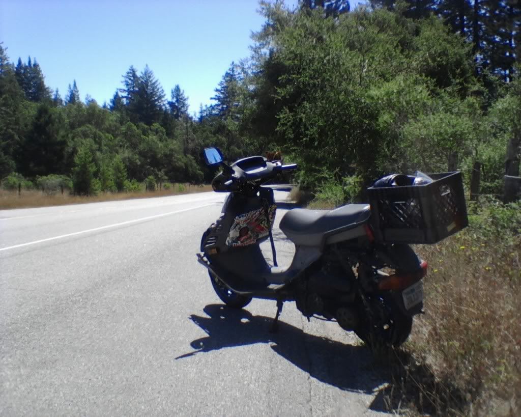

1987 Honda Elite 150. 14000 miles and pretty ratty. This problem is odd and difficult to explain, so bear with me.
Example: scooter is running great, then I let off the gas and compression brake to a stop. Nine times out of ten it's fine, but one time out of ten the moment I let off the gas the compression braking is much stronger than normal, and the scooter vibrates a lot more. When I accelerate again, power is down by half, and the top speed is 35 mph. The engine heats up as well. But, if I shut off the engine and start it again seconds later, it rides like normal.
This only occurs on longer rides (10+ miles, this is long for a scooter) It never occurs while cruising, only when I let the throttle all the way off.
Any ideas? Pic for fun:
