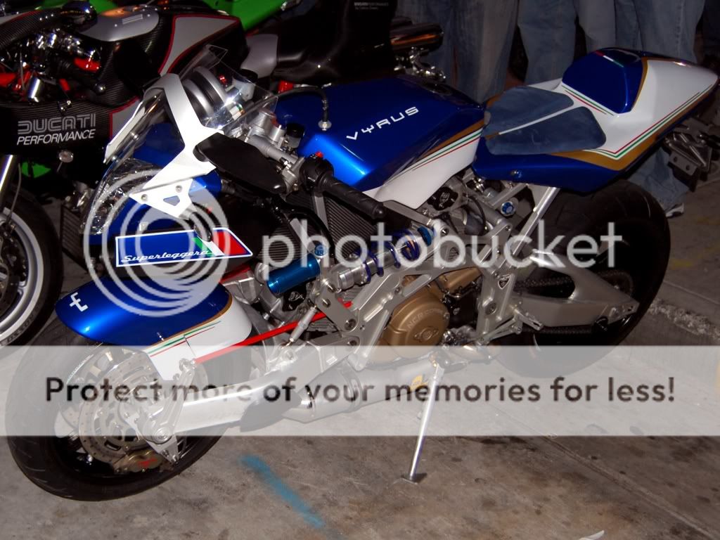

I think the bike is amazing and I love that someone is taking a clean-slate approach to a (semi)production sportbike. I find it crazy that it's been over a decade since the Britten, and basic sportbike architecture is still exactly the same.
Even if this thing is unreliable, unbalanced, and scary to ride I love the fact that they're trying different things in the name of weight loss and improved handling. If I had the dough, I'd buy one of these before a D16. Although I don't think I'd get the supercharged version.\

From the way Rodorigo describes the bike versus the Tesi, they took "suggestions" from the Tesi (which Rodorigo was involved with), but reworked everything. The overall concept is the same, but the mechanics are not. In any case, a lot of time has passed even since the Tesi 3D, and I'm excited to see someone continuing to push for real innovation. To achieve a road legal sub-350-lbs, full-displacement bike is pretty spectacular.

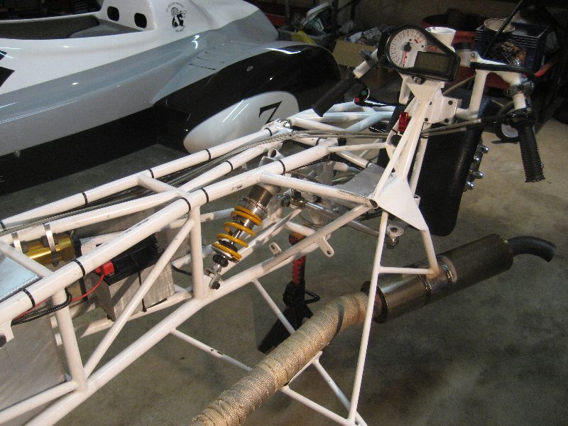

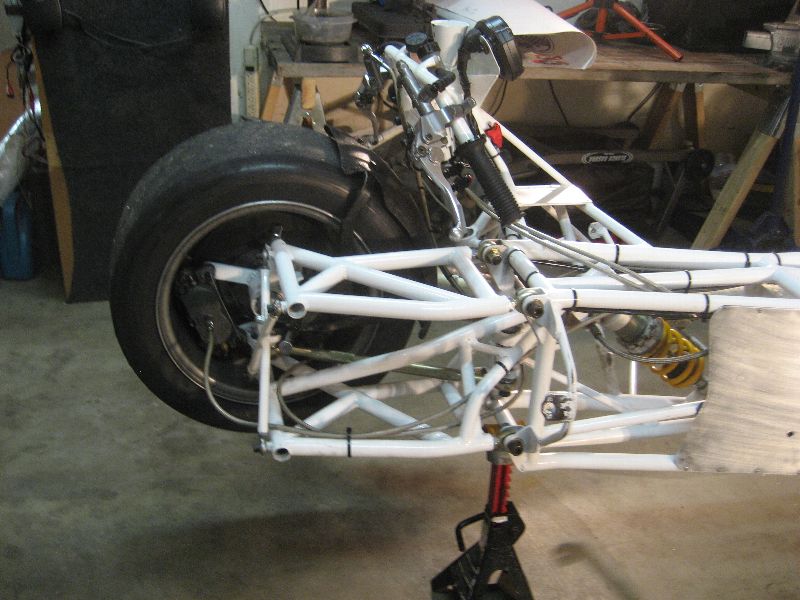

I don't know... you tell me. Here's the steering linkage off the Becker, which has a similar front suspension... A two rod bellcrank assembly turning not a small thin motorcycle tire but a massive 10 inch wide Yokohama slick.
Even at full tilt out on the track twisting into those bars with all I've got to control a drift or scrub off speed... I can't feel any any difference between left and right turns in the operation of the steering input.

No, it will not. It's a freely mounted two-force member. If you actually achieve buckling it is because you have crashed badly. In use, compression is identical to tension. Identical.
