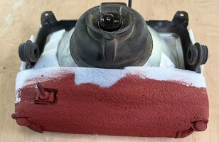

Working on the headlight, I had low beam too low, set up for slow speed dirt work.
I needed to raise my light for distance, also the light gasket was torn off that seals the mask to the light.
Big halo around the clocks, too bright.
New brighter H 4, socket was a bit stiff to remove, gave it a cleaning, with grease to make it easier to remove next time.
Mask gasket was thin sheet of expanded, closed cell foam, translucent, stock was the same in a light grey,
blocking light. I need to give my replacement a squirt of paint to capture light.
Headlight shaded, dimmed, & polished, in & out.
Working on centering, & distance.
