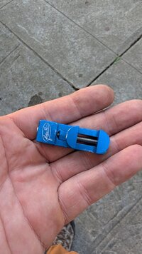

Decided to clean the front brake calipers and check the pads. On side looked fine with slightly more wear on the wheel side pads, but the other caliper had one set of pads down to about 2mm of material and the other side with plenty of material. Check piston movement and the worn side pistons moved freely with a little lever squeeze while the other side didn't seem to move much at all. Swapped pads around to buy some time, but I probably should do the work before I go rail on this thing as this seems like a bit too much drag... I will also confirm that the front wheel is installed correctly because the internet says there's a particular way the KTM 950 front axle is supposed to be installed to keep things centered....

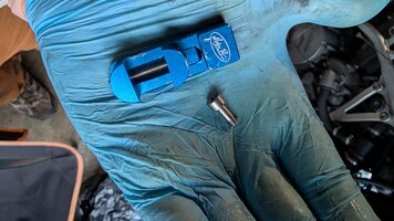

Well, the motion pro tool didn't work, maybe I need to separate the caliper halves? I have a compressor just can't run it in the garage for fear of blowing out a breaker I don't have access too. Am I gonna be able to blast those out with the calipers intact or would I still need to separate them?
That's a great tool tip, I was wondering how to blow out monobloc caliper pistons. The answer is not to.
