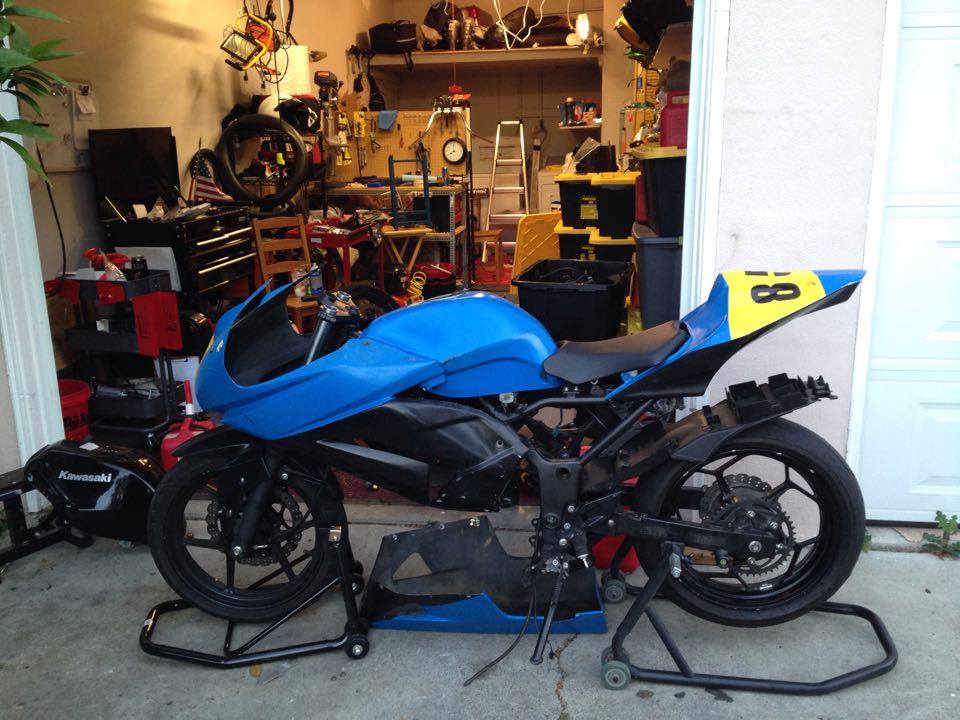

Ninja 300 engine into a Pre-gen 250
Hi, I'm gonna do same thing like you did.
I have running ninja 300 engine and seized ninja 250r engine.
If you had used ninja 250r engine bracket, you don't need to cut the engine 10mm, I think.
What ic igniter are you using??
Pre 2007 and after 2007 model are different..
I'm living in San Jose and I would like to check out your bike if you have time.
Thanks
Go ahead and PM me.
I used the pre gen Flywheel, and stator cover (removed the stator for racing). It has only 2 pick magnetic pickups to go with the pre gen igniter.
Im sure the 07 flywheel and stator cover which has multiple pick ups will also work so you can use all 250r stuff already on the bike. But I believe the 250r and 300 share the same pieces in that aspect so you might not have to change anything
The 250r has 28mm throttle bodies, and the 300 has 32mm throttle bodies.
Since I ran Carbs I was able to use 86-87 ninja 250 carbs which are 32mm. (88-07 are 30mm). So, you might benefit from running the 300 throttle bodies, but I have not messed around with it yet so I cannot say for sure it will work, but it should, with ECU tuning.

I set both engines to DTC on the Flywheel pulled both off and found the woodruff key to be in the exact same spot. After bolting the pre-gen on the the 300 engine, I took the pre-gen cover and success!!! The cover fits!!!!!! stay tuned!!
