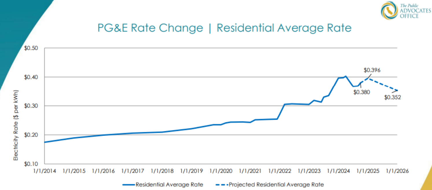

Please help my Dad understand his PG&E true-up increase
Hey Mike-
Armchair quarterback here in this area.. Love nerding out on this sort of stuff. It could be a myriad of things but settles out into one of the few:
1. Solar not producing enough
2. Using more power than you expect
3. Cost of power going up.
We can download your PGE usage over the past few years and likely link it to your solar data to see where things aren't lining up. 2024->2025 seems what I'd expect. Power rates went up 5x last year. 2023->2024.... that's steep.
I thought what PG&E has been doing with solar is changing the rates that you sell back the energy
For example:
You buy the electricity at 30 cents / kWhr
You sell back electricity at 15 cents/ kWhr, because that is more like a wholesale rate
For example:
Yes... this is NEM3. Wholesale rate is even lower like 0.03-0.05c per kWh.
