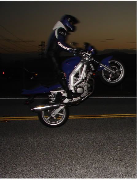

EEEEkk,
Hey, nice bike mang! Must have taken a while to get it right! Question: What kind of forks are you running up in front? Can you use the sv front wheel and also would I need to buy new calipers? Aight man dig the ride!!
Twin Works Factory did the vast majority of the work, like everything but the paint and the front end (it did actually have a little nicer front end...long story there).
This front end is off a '02 GSXR1000. The stock SV wheel might be able to be made to work, but going with the GSXR wheel meant I didn't have to mess around with spacers or anything.
Did you do anything to the rear end? If so what did you do, are you still running a 160 tire?
What are you using for a damper if any? I am considering a Scott's but don't know which one to get since I have the Gsxr triples and Sv tank. I bought an Ohlins but could not get it to work without bumping the lower triple clamp :(
Where's a good place to start for the front ride height? Right now I'm at 5mm above the triple (03 GSXR 750 front end)...
I had a Scotts on my old Race bike. I bought one for the GSXR and it mounted up with no issues.
This bike has a Toby in basically the stock GSXR location. The huge advantage to this is I don't have to take of the damper to lift the tank.
The rear wheel is from an F3 and will take either a 160 Michelin or a 165 Dunlop. TWF sells spacer kits for the wheel.
I get all my work done and specs from Zoran at Twin Works Factory.
