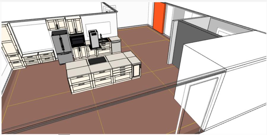

We are just getting started on a kitchen remodel. Hired an architect to give us some ideas. Going to take two walls out, already checked they are not load bearing. I have budgeted up to 80K hope to stay under 50K. Will be following this thread. I did go to the IKEA workshop on kitchens, they have an online CAD you can use to make a mock-up. Did the picture below on the IKEA site.
attachment.php
