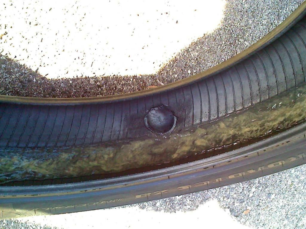

And here's photographic proof of both.
This tire got a puncture. I plugged it. A few thousand miles later the plug developed a slow leak. I took it to a local shop and had them replace the plug with patch shown in the photo. The patch leaked much worse than the plug. I added the Ride-On sealant shown in the photo to try and stop the leak. It did nothing. So I had the tire replaced. With the tire off it was obvious why the ride-on didn't work. It wasn't in the right place.

pretty ez to see that the repair was not done properly. i can c three things wrong with it just from the photo... tire wasnt buffed smooth as needed, patch isnt flat or pressed down properly, and theres no sealer over the whole repair. im sure u never went back to that repair place, but i hope u at least complained that they did the job wrong.
