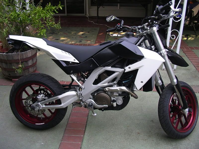

i have 2008 sxv 550 for sale if you're interested... 650 miles, no problems, no mods, still under warranty...
The 510 - along with the Aprilia SXVs - are really more race-bred bikes than street-bred, and they're finicky accordingly. The DR-Z is very much a street bike, with street-bike lack of worry. The other positive, since you say you want to ride dirt, is that it's easy to pick up a set of S wheels for a DR-Z and have a convertible SM/dualsport.

They make the SXV in an MX flavor - the RXV - but I haven't a clue about wheel interchange with those.
Yep, I'm talking about the Husqvarna SM510, which has to be the coolest of the hard core tards- not to take anything from the Ape SXV, which is the gnarliest monster ever (just took the overall at Pike's Peak, I think), but I'd have a hard time recommending one as I believe 'em to be too finicky. The Husqs are solid.
