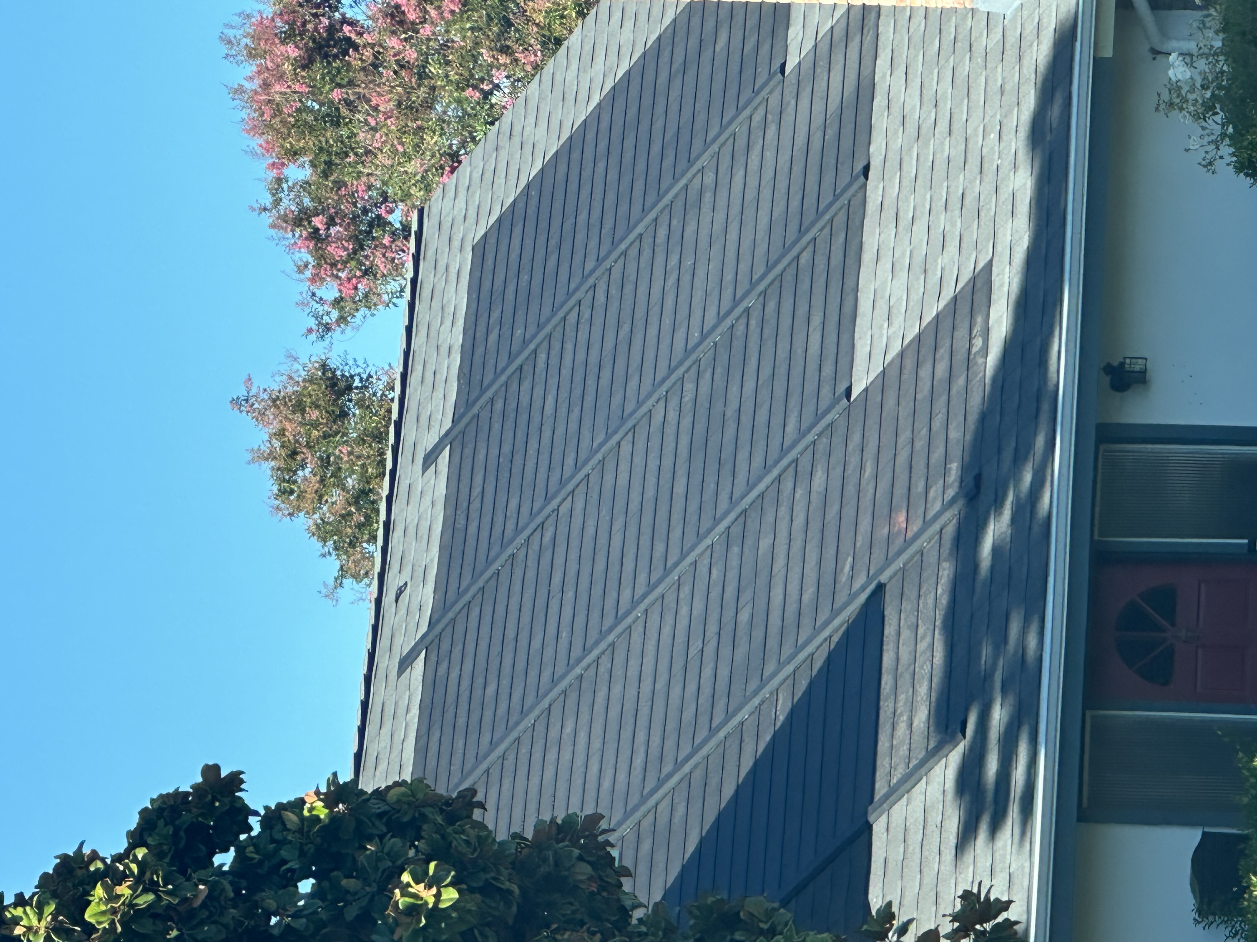

Saw this new roof with solar shingles installed
Anyone have thoughts as to what is better or more efficient - Panels or shingles?
