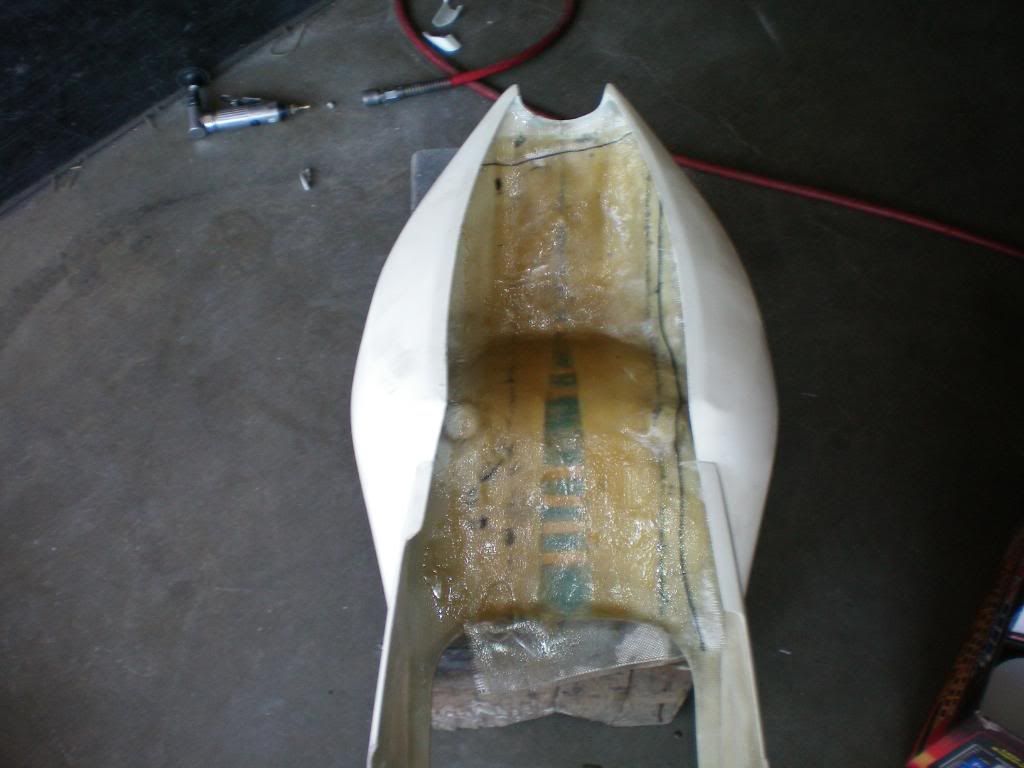

Today I was able to get my tail section fitted and fiberglassed back together, I still need to do the finishing fiberglass work but its together and strong. I also made my exhaust mount and fitted my muffler.

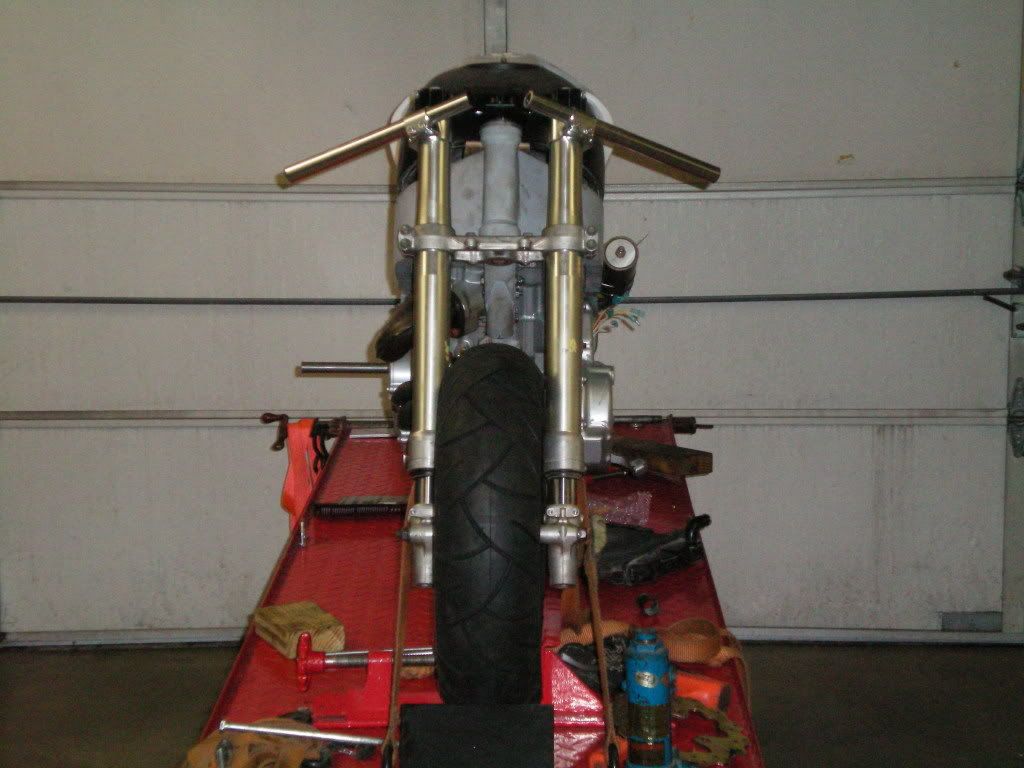

so what is the gig with the front suspension?
looks like it only has like 1 inch of travel?!

As for the front forks they have 1 3/4" of travel at the moment but I might be putting a littel more length back into them before its all said and done.

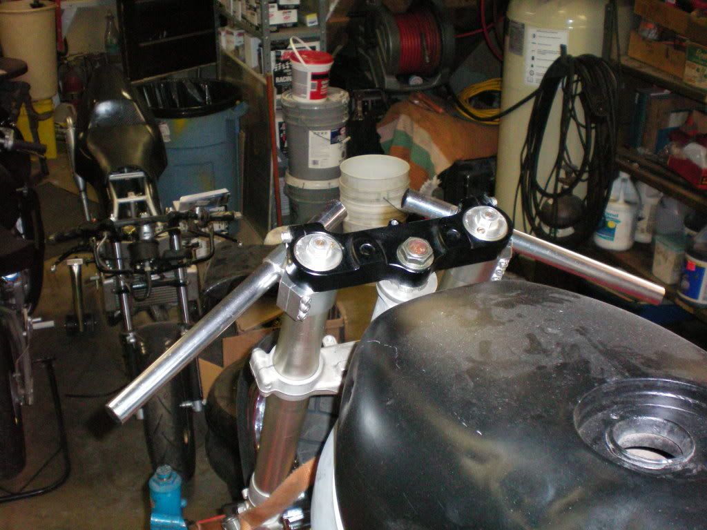

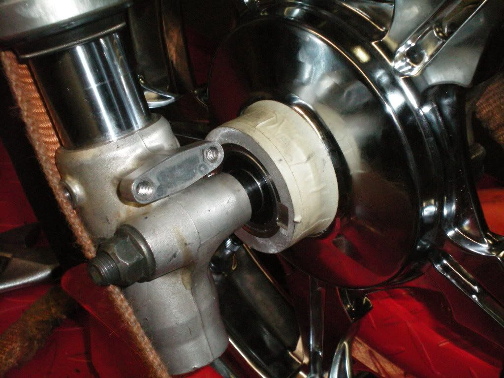

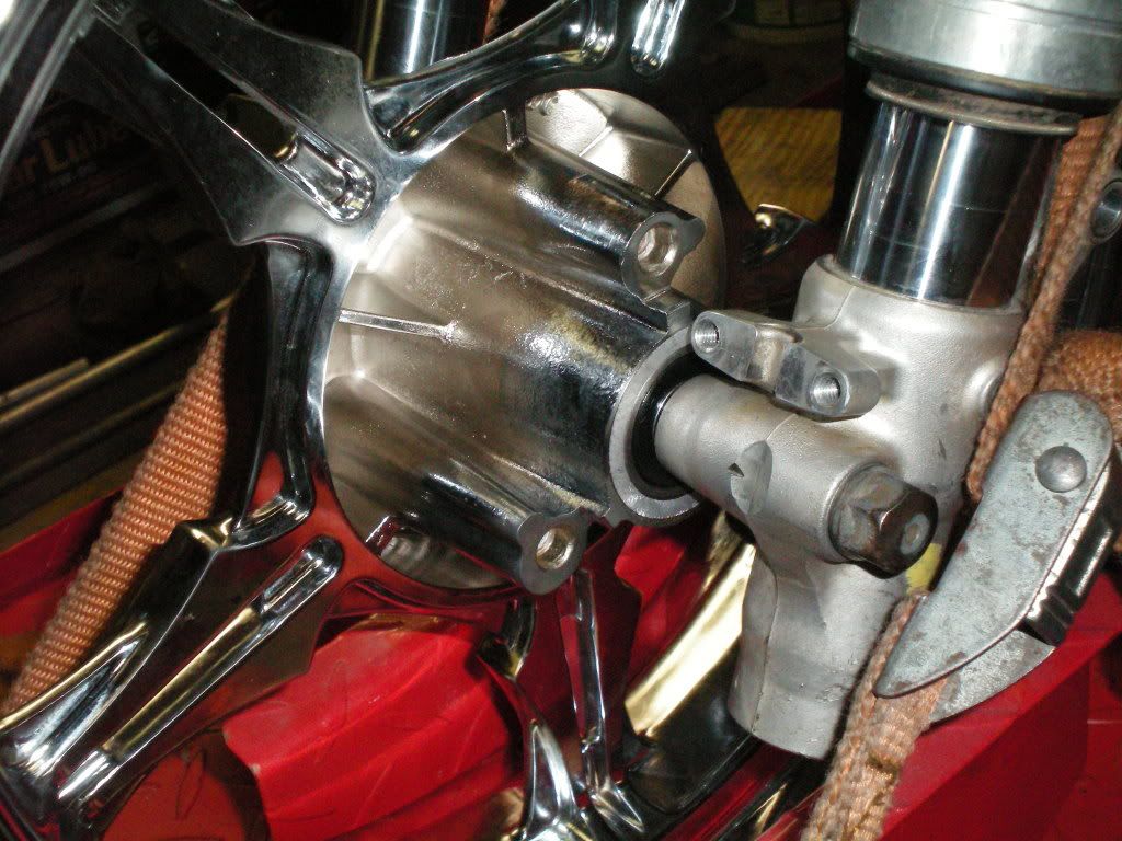

Today I did a Little machining on my front wheel and made some spacers for it. I also got my clip ons yesterday and installed them this evening.
That thing is SICKKKK
