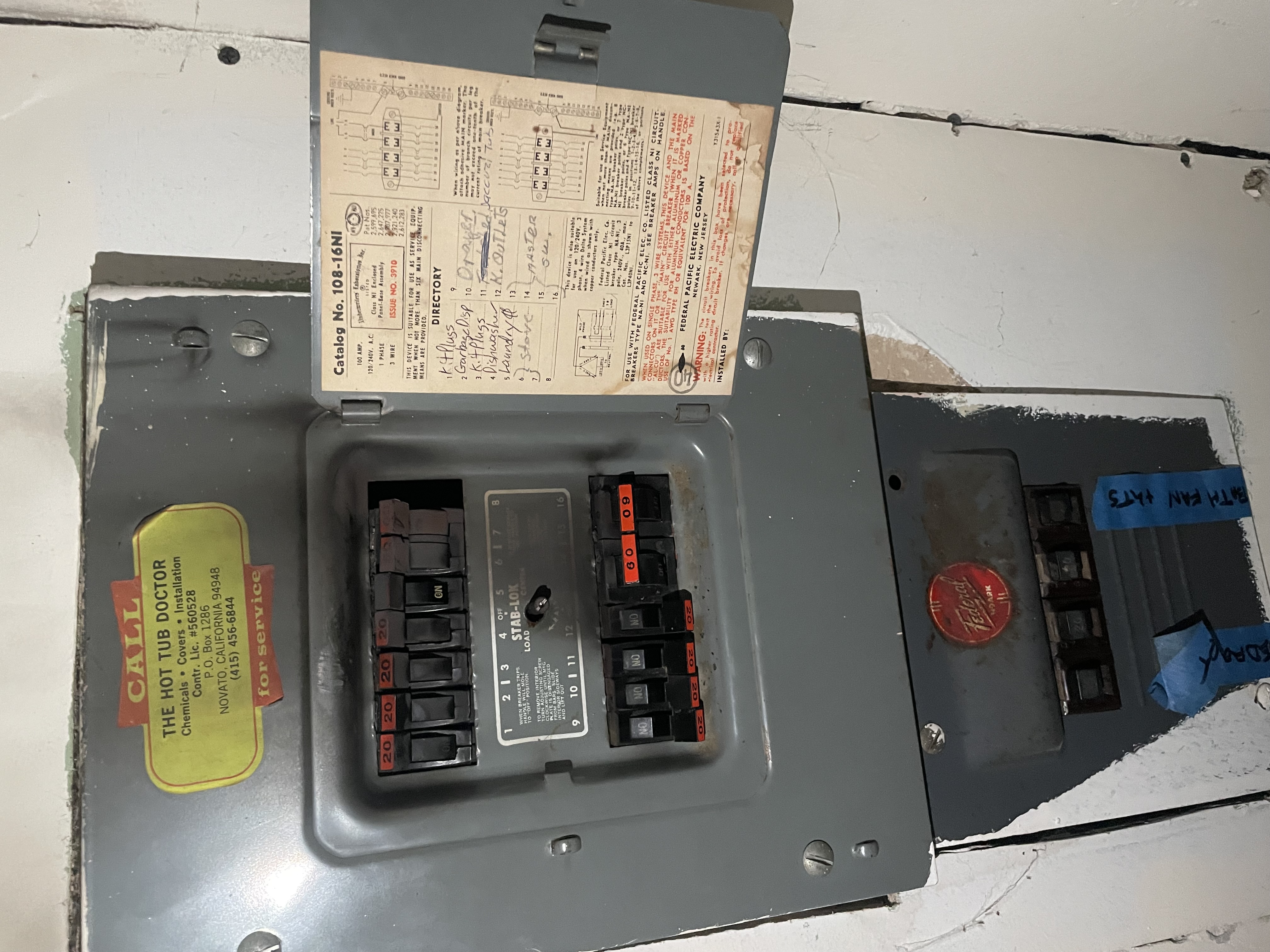

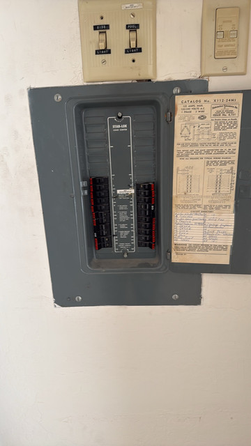

The house we bought in Concord was built in 1965. I’m on the fence on needing to replace the breaker panel.
Online research says I should have replaced it yesterday that it’s a surprise the house hasn’t exploded yet.
My contractor father who does a lot of his own electrical says ‘you’re fine, save the $$’ which isn’t really an endorsement or vote of confidence. A coworkers electrician friend said only replace it if there’s a problem. There hasn’t been.
It’s a Stab-Lok panel. Not sure if it’s made by Federal Pacific Electric.
Non permit swap is about $1200-$2,000 from some local electricians.
I’d like to know if I SHOULD replace it and if so, if there is a way to check why? From my research it’s more a precautionary.

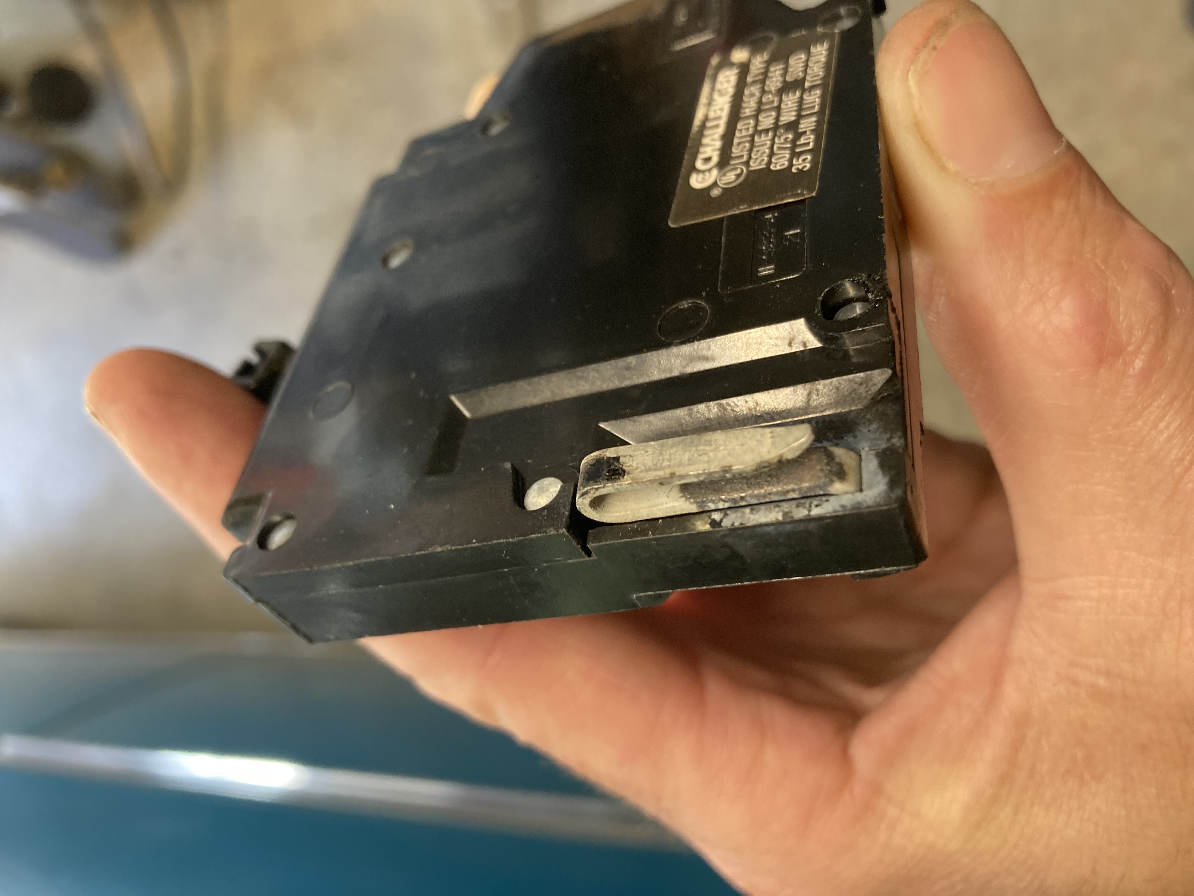

Good old Stab-Lock almost burned my house down. My home owners insurance covered about 2/3 of replacing the panel. IMHO, replacing a Stab-Lock panel should be a priority.

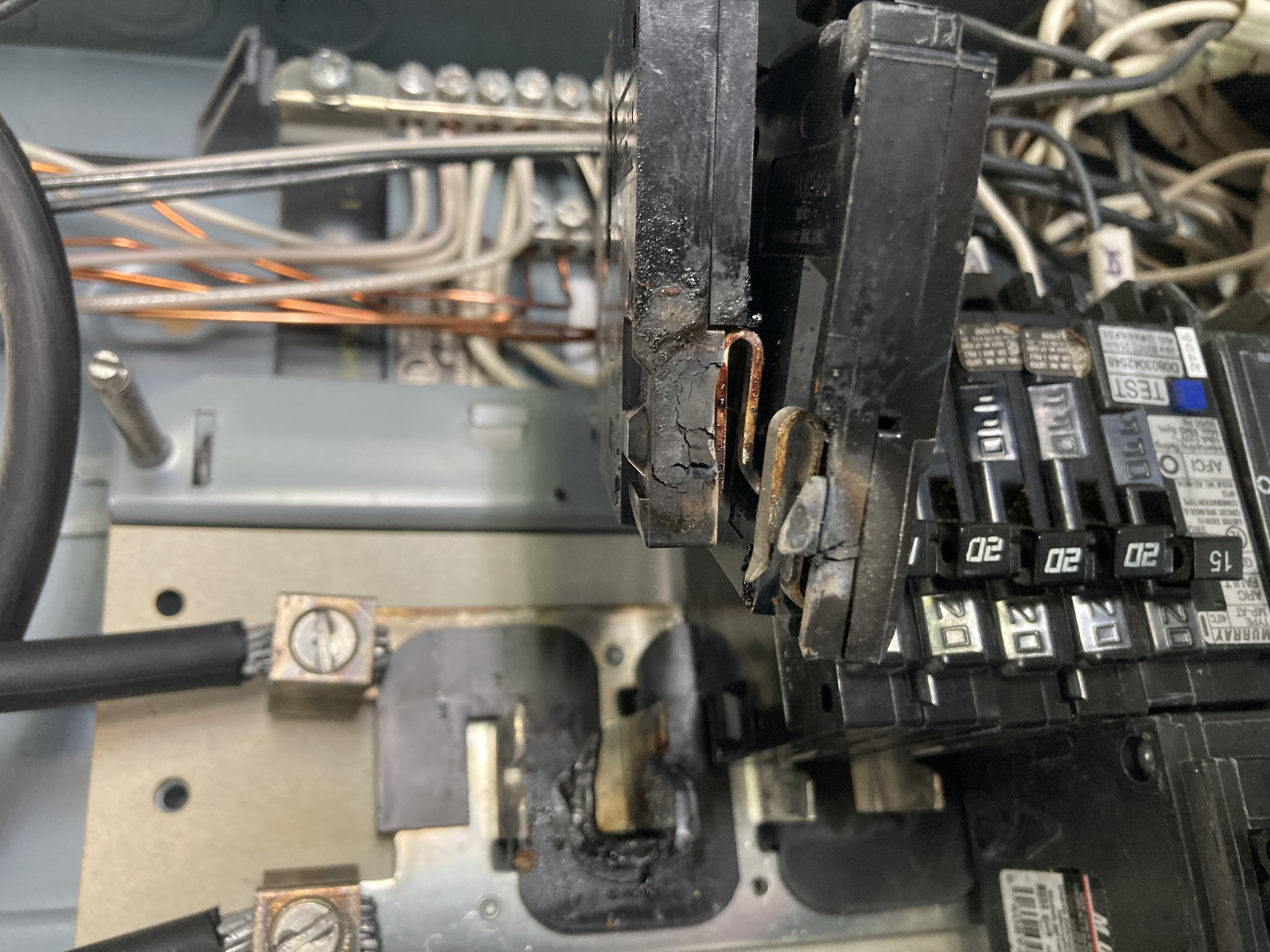

Just to put a finer point on it. If I hadn’t been home, awake and curious about why the lights were flickering, I would have had a house fire. A Stab-Lock panel WILL fail eventually. Mine appeared fine until it was arcing. I lived in the house for years with no problems. And then the mess you see above happened in minutes.

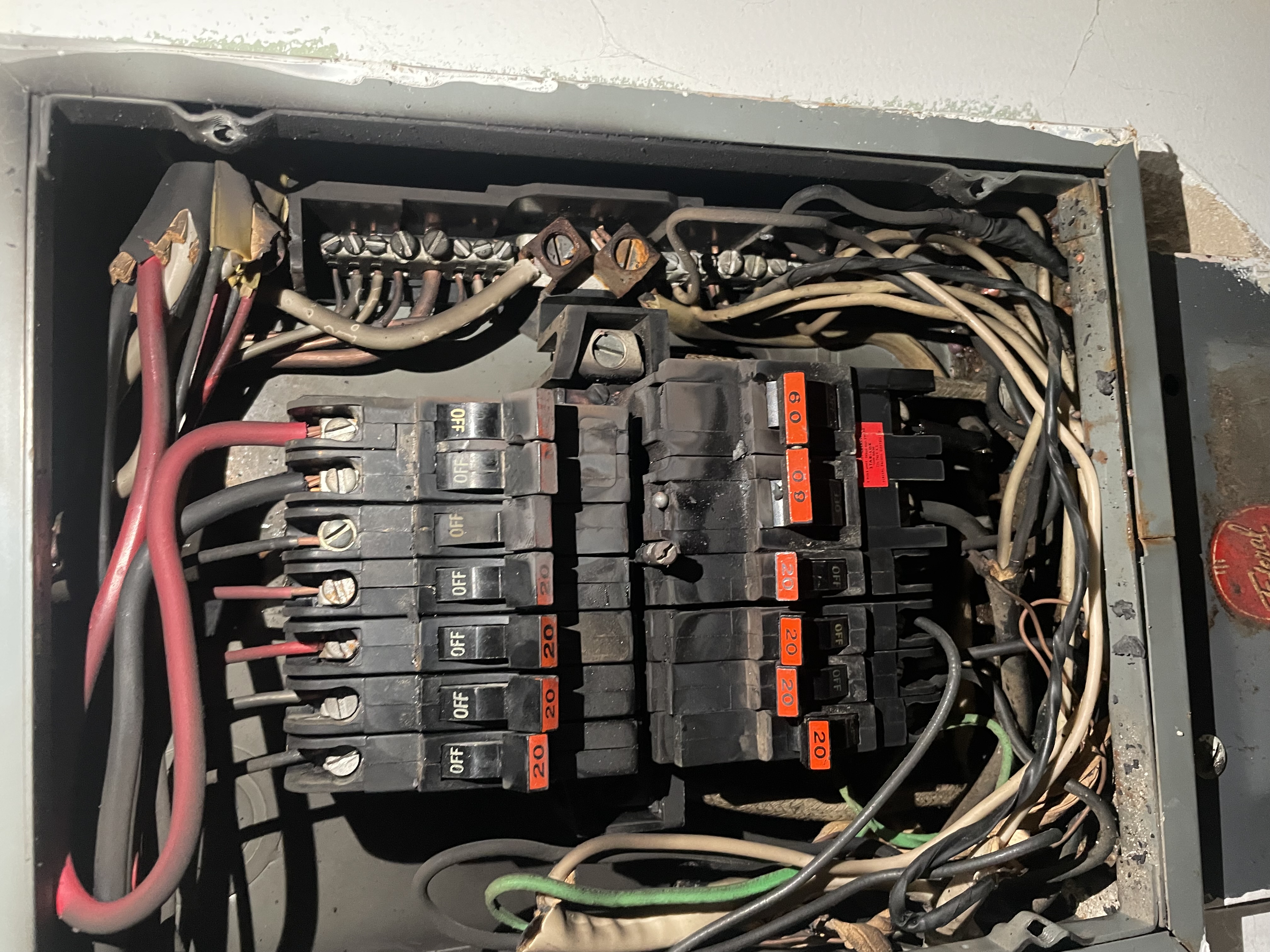

The electrician said “ you’re lucky the house didn’t catch on fire”
This panel was replaced with a surface mounted panel on the outside of the house. Including a new drop that was done just outside of the building through the eaves of the roof.
We also installed a new subpanel to feed the house and use some of the wiring in the existing panel and connections as a junction box.
This was a 1952 build.
Yeah, looks kind of bad don’t you think?
