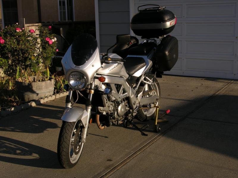

Could I see photos of your setup, or a description? I love riding at night, but yeah, it is hard to see around bends without external lights.
Well, it's not the best picture of the lights setup, but here's a photo I have laying around:
The lights are attached to the radiator.
