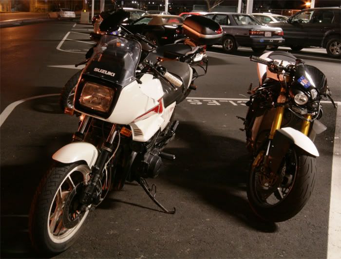

Threw a rod in 06 or 07... eastbound... IN THE TUNNEL. Had to run and push it a quarter mile out. Thank Jesus there was one of those pg&e trucks with the cherry picker on top. He turned his amber lights on like an angel and drove behind me so nobody ran me over. Worst part was breathing that tunnel air with the helmet on while trying to run this 500 lb thing out.
I was looking for pictures of it but these were all i could find.

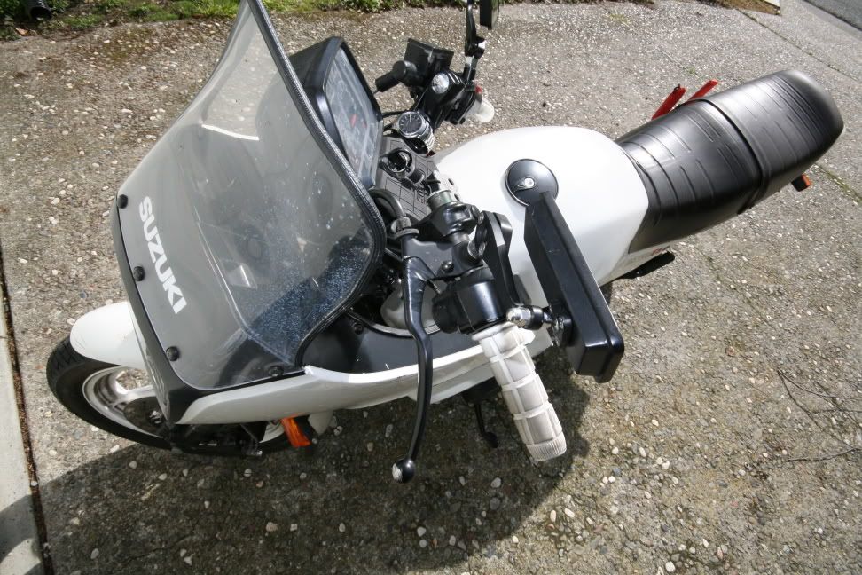

Finally Pics!!!
Finally got it out of the owners garage, put an AGM battery in it and it fired up! Rides pretty well actually too. Everything needs work but I'm just glad it starts and rides! Super psyched!
