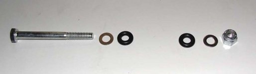

also i'm curious as to why you used this bolt, nut & orings to seal off the valve stem hole instead of just tapping the valve guide & threading a bolt into it with some thread sealer on it? if your bolt & nut set up ever comes loose the bolt will make contact with the piston, but if you had the valve guide tapped the bolt could never come in contact with the piston, since it'd be threaded from the cam side of the guide.
