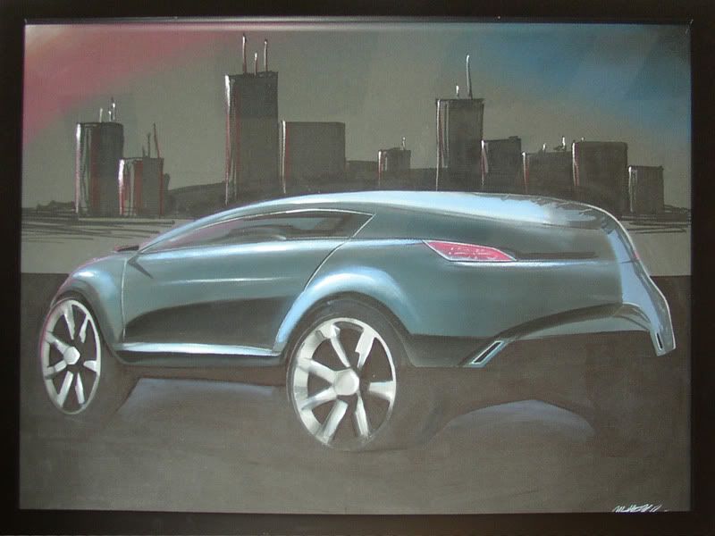

Let me know... I'm not half bad with a pen and pencil either
(here's a drawing I did for my lil bro for christmas a couple years back)
