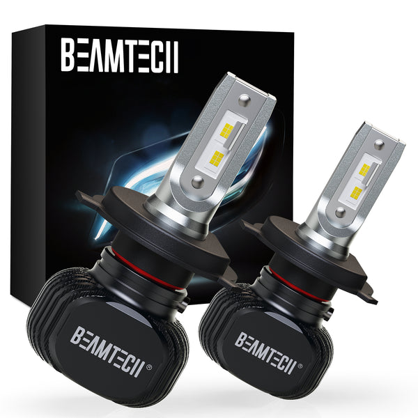

All of that said, one can imagine why an LED bulb cannot be made to produce the same light pattern in a halogen housing. The thickness of the board the LEDs are mounted to would place the light source much farther off the axis than the 0.2 mm referenced above, to say nothing of the light pattern of the LEDs themselves compared to a filament.

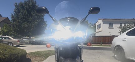

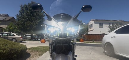

To our eyes, the light pattern may be acceptable, which is why many of us have made the conversion and find the results preferable; more light, longer life and no oncoming traffic is acting pissed off. Still, no LED manufacturer has made an FMVSS 108 compliant bulb and none ever will for two reasons:
  1. The manufacturer would need to demonstrate that its LED bulb does not produce glare exceeding federal limits at critical coordinates (such as the eyes of oncoming drivers) in any tested OEM assembly. None ever have.
  2. FMVSS 108 explicitly mandates that replaceable light sources for halogen housings contain a filament, so manufacturers would have to petition for a rule change, which none have. The market for such a product is shrinking as older vehicles age out, so they take their chances selling non-compliant bulbs.
