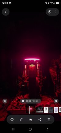

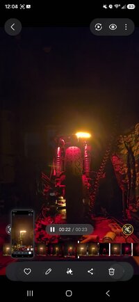

I redid all my rear lights and turn signals if my new headlight that comes in can use led i will swap that also
Started with rear then im moving to the front
