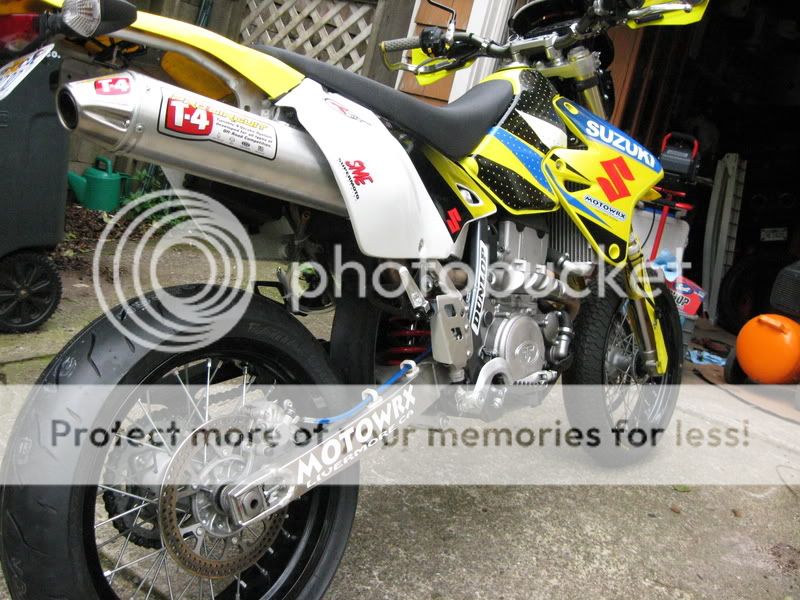

I have a full T4 system on mine, and it is pretty loud. I do, however, have a slightly more restrictive tip than yours, from the looks of it. Here's a pic, I'll let you decide. Maybe it's just shaped differently.
