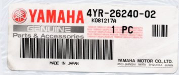

R1 throttle tube mod
I finally got around to doing the R1 throttle tube mod. I was in too much of a hurry to take pics but the ones that FrigginChi posted are representative.
http://www.bayarearidersforum.com/forums/showthread.php?t=227265&page=6
With an FCR39 the throttle rotation between fully closed to full open was reduced from about 83 degrees to 73 degrees measured with a degree wheel indexed by eye on the brake lever; from about 1/4 to 1/5 turn, 12% quicker. I'm pretty sure that the FCR requires more rotation to full throttle than the stock carburetor. I don't remember tweaking on the throttle throw until I swapped to the FCR.
I traced the stock throttle tube's shape onto a piece of clear packaging tape to make a template and used a die grinder with a carbide burr to trim the R1 tube to match the DRZ's stock tube.
The stop on the open cable side seems to just need to clear the cable housing fitting.
The clock was staring at me and the stop on the close cable side seemed less important to me so I was a little less precise with it. As a result, it is now possible for the throttle tube to hang up slightly on the housing after the throttle is forced shut, twisted with some force beyond it's natural closed position. No big deal but not 100% perfect.
The throttle tube is Yamaha part number 4YR-26240-02-00 which supercedes the 4YR-26240-01-00 cited earlier in this thread.
Before I ordered the R1 tube, I found that all DRZs seem to use the same throttle housing (57110-14D00) but the throttle tube for off road FCR equipped ones has a different number than the street (and green sticker?) legal DRZs. Those throttle tubes are 57100-14D11 and 57100-12D11, respectively.
The 14D11 was more than twice the cost of the R1 part and I read a post on Thumpertalk where some Aussie was complaining about the throttle pull being too long on a DRZ400E so I went with what is proven to work. That 14D11 part could be the magic no fabrication bolt-on, though.
Suzuki part numbers are from ronayers.com and may not jive with Suzuki part numbers.
Throttle tube PNs: 2004 Yamaha YZFR1 4YR-26240-02; 2006 Suzuki DRZ400SM 57110-12D11; 2000 Suzuki DRZ400E 57110-14D11; 2006 Suzuki DRZ400E 57110-14D11.
