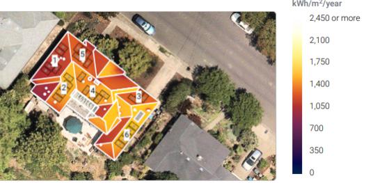

We ended up with 20 panels in areas 1, 2, 4 and 6 and none in areas 3 and 5 for 118% of current use as we will be adding some electric wall heaters, (Envi made in US), to raise the ambient temps at night in the house which we don't heat at night so the gas fireplaces with use in 2 areas are used far less.
Evidently as we will have to move from the tiered PGE rate plan to time of use, (where 4-9pm is premium pricing) the panels in area 1 facing NW will capture the late afternoon sun, albeit at a lower amount than the other panels but at greater reimbursement $/kWh so they were deemed advantageous.
Cost per kWh with them is about $2.60/kWh.

Thx - was hoping that there was some online tool that could show this :)
That photo is with dead North at the top so you can probably "guesstimate" by looking at your roof on google earth which parts of your roof would correspond assuming you have no shade from nearby trees.
Map would have looked quite different 2 years ago as to the Southwest in the rural cemetery there used to be 100+ Eucalyptus trees blocking later afternoon sun; they were 150 feet tall or so.
All gone now.
