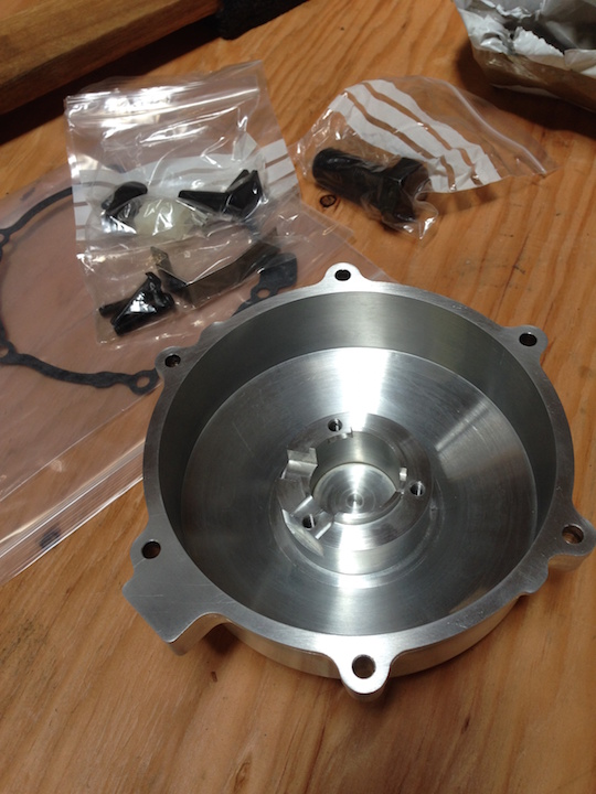

So I'm sitting here on my couch, literally with the front door open, waiting for the FedEx guy to arrive with a new NC35 tank. Waiting is boring, so why not post. I realize I never actually posted about the Rick Oliver generator conversion.
After my bike left me stranded at a gas station with a flat battery, I tested the charging system and found it to be marginal, at best. All of the components individually tested within spec, but voltages with the bike running (and with a freshly-charged battery) were at the low side of in-spec. I still ended up doing Thunderhill with no problems, as I recall, and I didn't even have to swap batteries between runs. But if there's new shiny parts to be had...
Mmmm tasty.
The gist is that you replace the NC35's stock charging system with parts from a mid-00s GSXR. It's not a simple swap, because the GSXR1000 stator bolts to the cover, while in the NC35 the stator bolts to the case. As a result, you use the new stator and rotor with a custom cover.
Gotta give credit here, this is an exceedingly well-designed and made part. The kit comes totally complete, with the right plug and pins to graft onto the GSXR stator. The gasket is pretty meh (and I ended up tearing it on the install, and having to fix it in North Carolina - nothing quite like riding up to the Tail of the Dragon in the dark and then realizing that your bike is pissing its oil all over the rear tire), but it's serviceable.
Once installed... well, you cover it up with fairing. Which is a shame, because it's really pretty. With it, the bike revs really, really quick. I don't remember the weights any more, but the GSXR parts weighed something like 1/3rd what the stock pieces did. It gives a fairly quick-revving bike some real snap and crackle as the revs jump up. I don't think I'll ever notice the difference in terms of power delivery, but it sure does sound nice when I'm revving it at a stoplight. ;)
