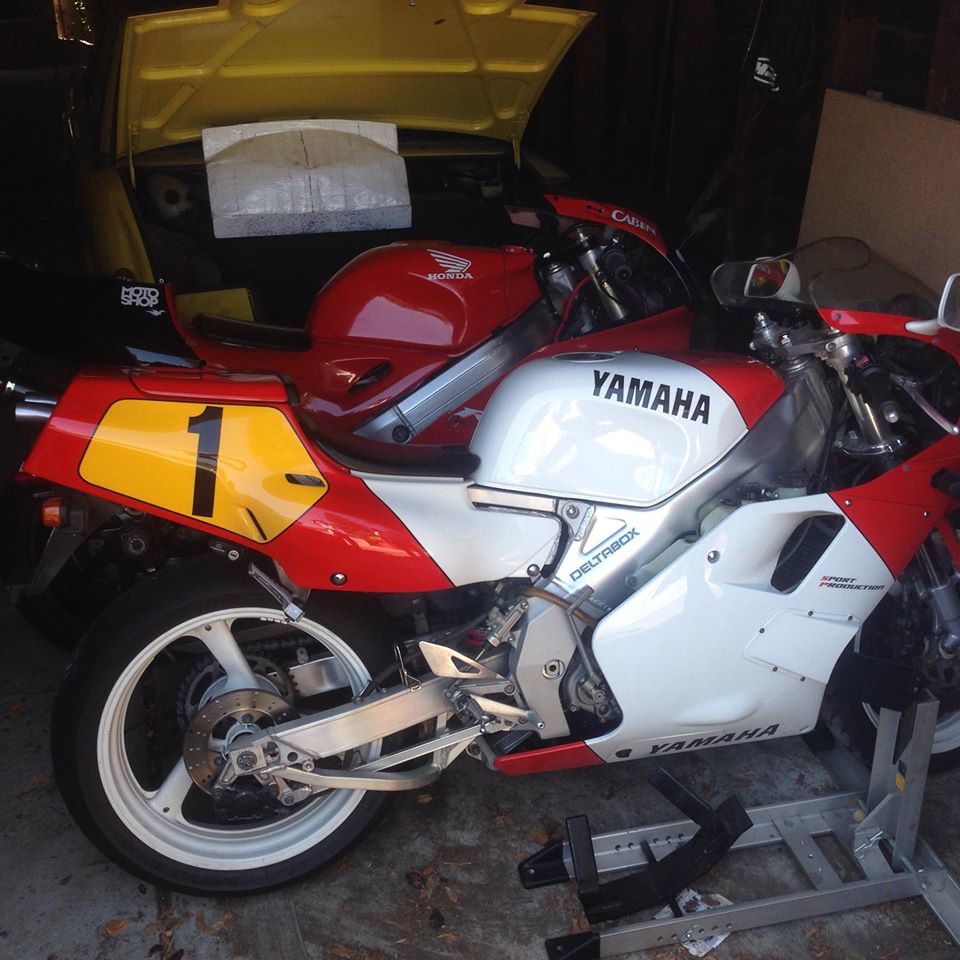

WELL THAT WAS A SHORT RELATIONSHIP WITH A TWO-SMOKER
I admit, the poor RVFlette sat and rotted while I dallied with that TZR, but the TZR went to a new home two days ago and I've been thinking about this box of fun RVF parts collecting dust...
