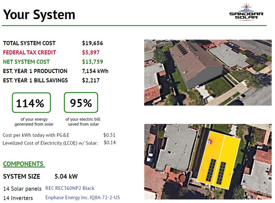

Here are three quotes that we've got so far...probably pull the trigger in about a month or so when we file taxes.
Would appreciate any thoughts, comments, or suggestions : )

The image that has "Standard x15" panels - I asked them which panels they are, and the guys said "REC - Canadian 370W".
